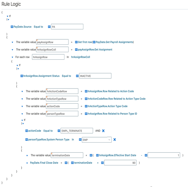

Termination Date for an Assignment is not directly available. You need to navigate the internal data structure through existing accessors to find the Termination Date.
The below rule sample is an example on how to obtain the Termination Date variable.
