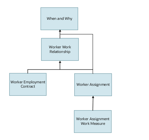

The When and Why business object is a part of Employment.
In addition to directly using the business object for defaulting and validating, you can also use it as a criteria to achieve other defaulting and validating in objects that are called in subsequent sections involving the Employment Details section.

To Other Objects from When and Why
This table lists the objects that you can navigate to from the When and Why business object.
