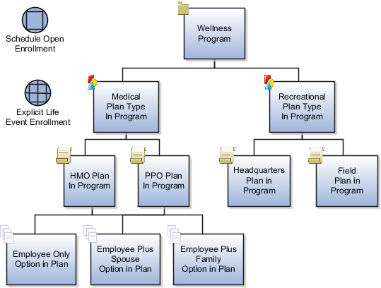

Wellness Program Example Scenario
Your organization is creating a wellness program that's for current and retired employees only.
The program hierarchy includes:
Two plan types: medical and recreational.
Two plans within the medical plan type: HMO and PPO
Three options for both medical plans: Employee Only, Employee Plus Spouse, and Employee Plus Family

Enrollment Setup
You create the Wellness benefit offering and attach life events at the highest hierarchy level for open enrollment and explicit life event enrollment.
The following table identifies the enrollment requirements that you configure at each level in the hierarchy.
Level |
Enrollment Requirement |
Program |
Attach the Scheduled Open event and configure the November enrollment period for the Wellness program |
Plan type in program |
Attach the Add a Child life event and Marriage life event to the Medical plan type and configure the enrollment period and other settings for each event. This configuration provides medical plan enrollment opportunity at any time during the year for Wellness program participants who add a child or spouse to the family. None for the recreational plan type |
Plan in program |
None for any of the plans. Enrollment requirements for the Medical plan type cascade down to the plans under that plan type. |
Option in plan |
None for any of the options. Enrollment requirements for the Medical plan type cascade down to the options in plans under that plan type. |
