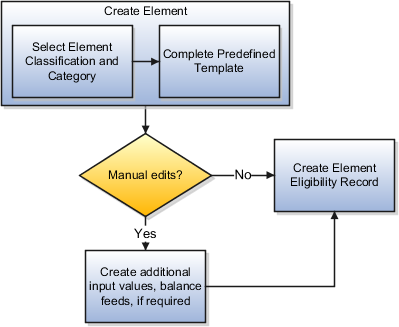

Use the Elements task to review elements and to create new ones. When you create an element, your selection of the element classification and category determines the questions on a predefined template. Submitting the template generates an element, which you can edit, as required.
You must create at least one element eligibility record for all predefined and newly created elements.
This figure shows the tasks involved.
Create an element by completing a predefined template, updating the resulting definition as required, and by creating an element eligibility record for it
