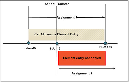

Example 2: Recurring element entry dates are after the global transfer date
Let's consider the previous example of the employee. This person has paid a car allowance of $500 that starts on 1 June and ends on 31 December. Effective 1 July, the company decides to increase the allowance to $600. On 1 May, you transfer them to a different department within the same company.
In this case, the process doesn't copy the recurring car allowance element entry.
