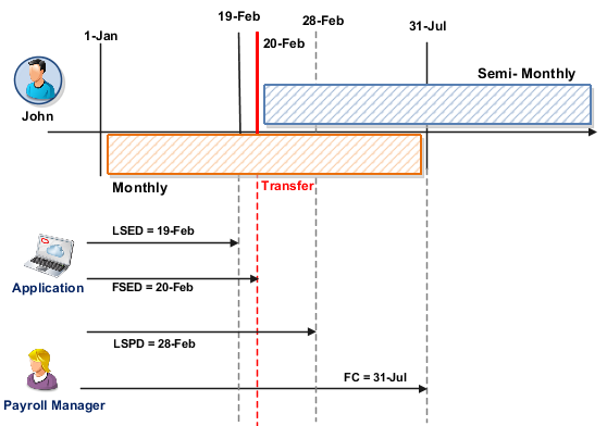

Let's consider this example.
John is on a monthly payroll, but starting 20-Feb-18, he's transferred to a semi-monthly payroll. His monthly and semi-monthly payroll definitions looks like this. You can update the final close date as 31-Jul-18.
| Time Definition | Monthly Payroll | Semi-Monthly Payroll |
| First Standard Earnings Date | 01/01/18 | 02/20/2018 |
| Last Standard Earnings Date | 02/19/2018 | |
| Last Standard Process Date | 02/28/2018 | |
| Final Close | 07/31/2018 |
