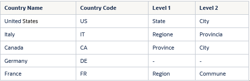

You can define the geography hierarchy structure for various countries using the geography hierarchy structure FSM. You can select a maximum of two sub-levels per country.
For example, you may configure the two sub-levels for the United States in the following ways:
Level1 - State, Level2 - City
Level1 - County, Level2 - City
Given below is the geography structure for various countries used in GeographyHierarchy.dat.
