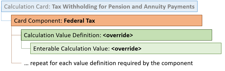

Each Tax Withholding for Pension and Annuity Payments calculation card should have one Federal Tax card component.
Federal Tax Card Component Hierarchy for Tax Withholding for Pension and Annuity Payments
The Federal Tax card component uses value definitions to capture override values. Value definitions are supplied using the Calculation Value Definition and Enterable Calculation Value record types.
