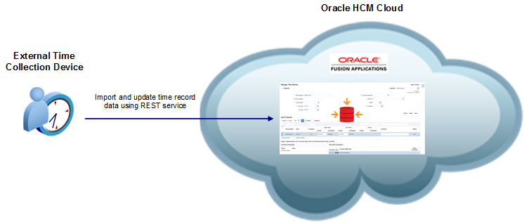

You can use the timeRecordEventRequests resource to create any time entry. If a time card doesn't already exist, the process creates it as well.
The following figure shows that you can use the API to import data from an external time reporting application to, for example, clear exceptions.
The worker Tom was assigned a work schedule with the 8:00 AM to 5:00 PM shifts for Monday through Friday. A time card with the status Saved already exists for Tom, for the current week. On Monday through Thursday, Tom reports time from 08:00 AM to 05:00 PM, as expected, with the Regular Hours payroll time type. On Friday, Tom forgets to report his time, so his time and labor manager imports Tom's missing time using the REST service. The imported time entry has this information.
