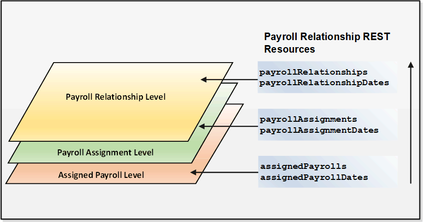

This graphic shows the various REST resources available at the payroll relationship, payroll assignment, and assigned payroll levels.

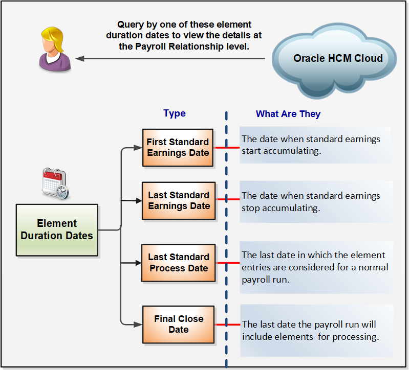

Element duration dates at the payroll relationship level control the start and end date of earnings and deductions assigned to the employee's payroll relationship. Examples of payroll relationship elements include tax and social insurance entries.
You can use the payrollRelationshipDates resource to retrieve these date
values.
- First Standard Earnings Date
- Last Standard Earnings Date
- Last Standard Process Date
- Final Close Date
Here's a graphic that helps you understand the scenarios.
Let's say that the application has set the last standard earnings date on John's assignment record as 1-Mar-19, which is his termination date. The same date cascades up to the last standard earnings date at the payroll relationship level.
