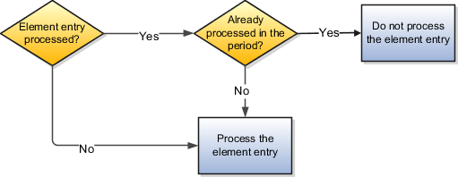

Process Once Per Period
Use the Process once per period option to check if the element entry has been processed or not.
As this figure shows, change this field both from Y to N and N to Y even if element entries or run results exists.
You can change this field both from Y to N and N to Y even if element entries or run results exists.
If the value of the option is Y and the element entry is already processed in the period, then the application doesn't process it again.
If the value of the option is N, then the application processes the element entry even if it's already processed in the run.
As this figure shows, depending upon the value of the option, the application processes the element entry.
Depending upon the value of the option, the application processes the element entry.
