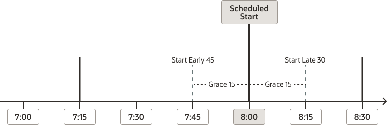

Check the In
In this scenario, the scheduled shift starts at 8:00a and has these limits:
- Grace period: 15 minutes before and after the start time (7:45a to 8:00a and 8:00a to 8:15a)
- Start early: 45 minutes, including the grace period (7:15a to 8:00a)
- Start late: 30 minutes, including the grace period (8:00a to 8:30a)
The formula uses the scheduled time and limits to check the reported start time against shift limits in this order:
- If it's between 7:15a and 7:45a, the formula displays the default start early error message HWM_FF_TDR_EARLY_IN_ERR and the corresponding error type Shift START_EARLY_ERR_TYPE. If it exists, the error type is the violation type set for the start early shift limit. Otherwise, it's the message severity set in the rule.
- Else if it's between 8:15a and 8:30a, the formula displays the default start late error message HWM_FF_TDR_LATE_IN_ERR and the corresponding error type Shift START_LATE_ERR_TYPE. If it exists, the error type is the violation type set for the start early shift limit. Otherwise, it's the message severity set in the rule.
- Else if it's before 7:15a or after 8:30a, the formula displays the default error message HWM_FF_TDR_INVALID_IN_ERR. It also displays the corresponding error type of the message severity set in the rule.
