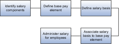

Managing salary involves these steps
Perform these steps to create an element to use with salary basis.
