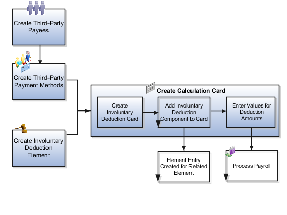

Defining involuntary deductions involves:
Defining third-party payees.
For further info, see Create Third Parties Options in the Help Center.
Creating third-party payment methods.
For further info, see Create Third-Party Methods below.
Define involuntary deductions elements, including eligibility.
For further info, see Define Involuntary Deduction Elements below.
Defining element costing info.
For further info, see Define Element Costing Info below.
Creating an Involuntary Deductions card.
For further info, see Involuntary Deductions Card for the US in the Help Center.
Creating an Involuntary Deductions card component.
Setting calculation values and calculation component details for individual Involuntary Deductions card components.
For further info, see the following in the Help Center.
Add Deductions to the Involuntary Deductions Card for the US
Overview of Involuntary Deduction Overrides for the US
Here's a look at the steps involved in creating an involuntary deduction.
