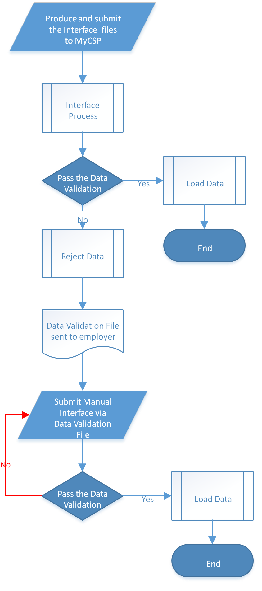

This graphic illustrates the data flow between the employer and MyCSP and how errors are handled:
mycsp data flows
The Generate MyCSP Interface process creates files containing standard code interface files that you submit to MyCSP. Each file contains fixed-width records, as specified by MyCSP. This process enables you to produce either the cutover or monthly interface files (that is, changes only files).
