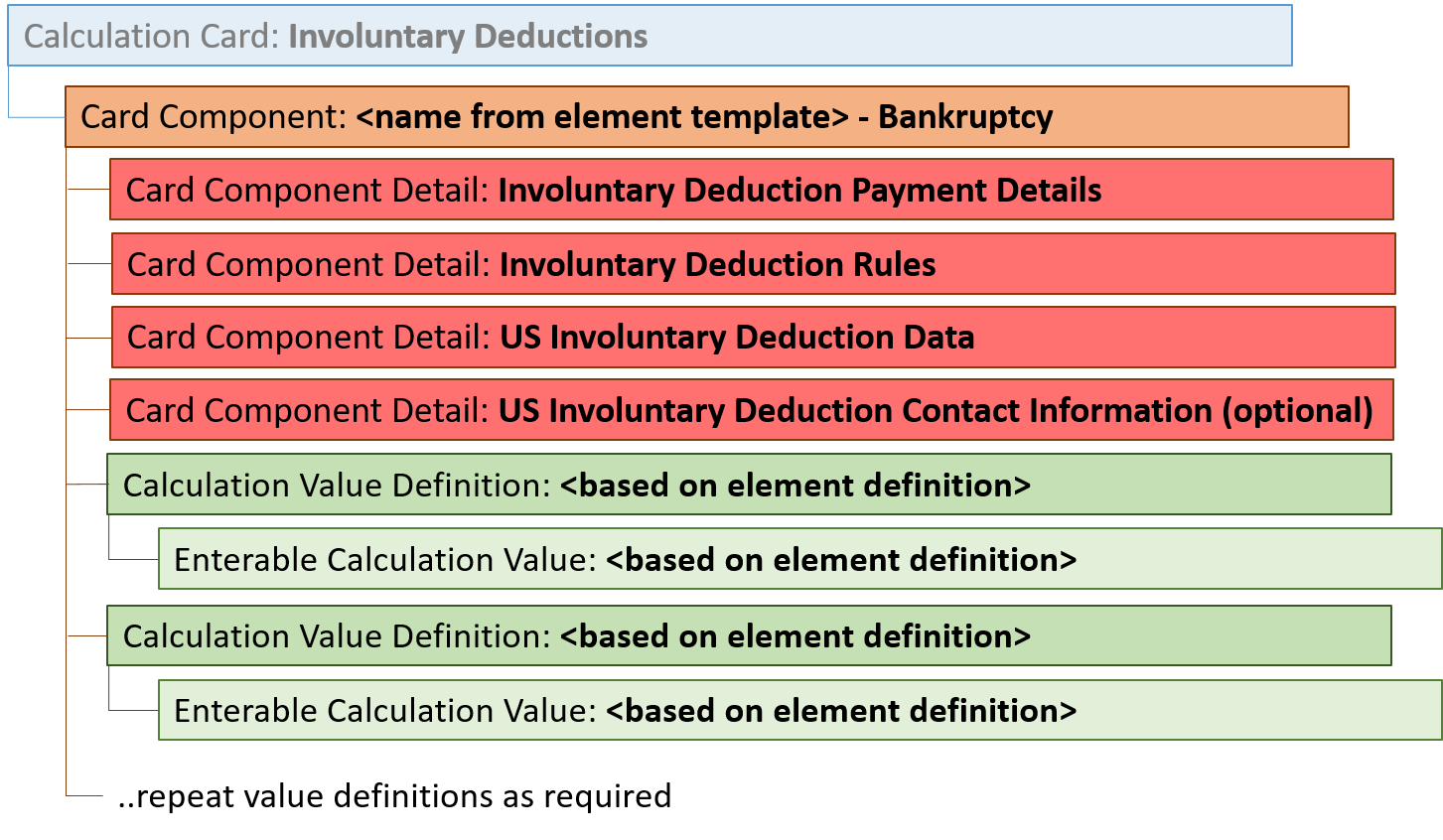

A bankruptcy order is issued as a result of a Federal court procedure that helps individuals get rid of their debts and repay their creditors. An involuntary deduction element using this secondary classification needs to be configured prior to creating the card component.
The card component name is defined by the element configuration, as are the value definitions which are supplied using the Calculation Value Definition and Enterable Calculation Value record types.
Refer to the Load a Card Component for US Involuntary Deductions for details of each of the record types and attributes you need to supply for an involuntary deduction.
The example file lines in the section below are always supplied together in the same CalculationCard.dat file.

The parent Involuntary Deduction Calculation Card is identified by the DirCardId(SourceSystemId) attribute which has a value that match the SourceSystemId attribute on the CalculationCard record.

The parent Card Component is identified on the ComponentDetails records by the DirCardCompId(SourceSystemId) attribute, which has a value that matches the SourceSystemId on the CardComponent record.

The parent Card Component is identified on the CalculationValueDefinitions records by the SourceId(SourceSystemId) attribute which has a value that matches the SourceSystemId on the CardComponent record.
The parent for each Calculation Value Definition is identified on each EnterableCalculationValue record using the ValueDefnId(SourceSystemId) attribute, which has a value that matches the SourceSystemID attribute on the parent CalculationValueDefinition record.
