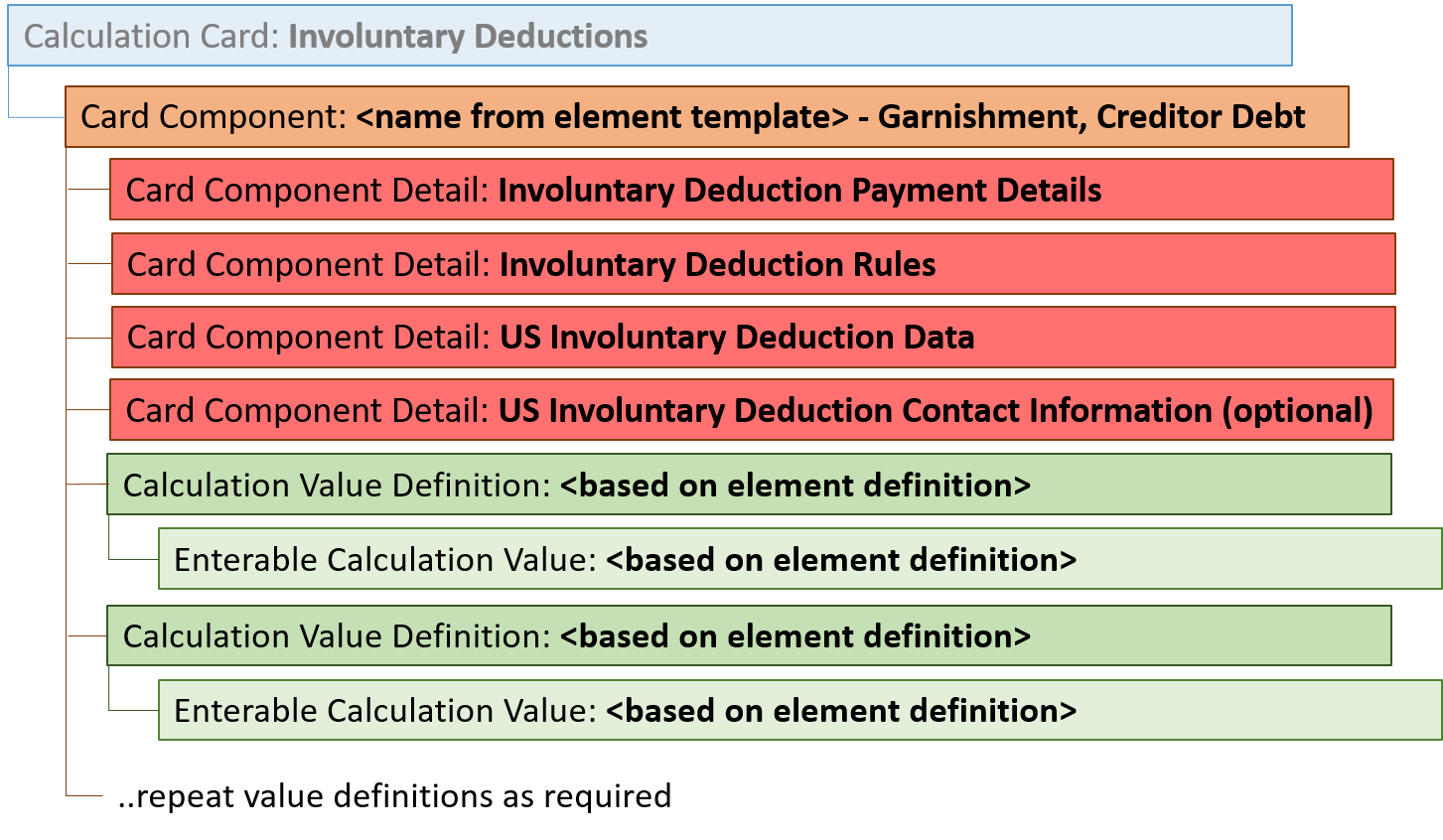

Wage garnishment or creditor debt occurs when an employer is required to withhold the earnings of an employee for the payment of a debt in accordance with a court order or other legal or equitable procedure.
An involuntary deduction element using this secondary classification needs to be configured prior to creating the card component.
The card component name is defined by the element configuration, as are the value definitions which are supplied using the Calculation Value Definition and Enterable Calculation Value record types.
Refer to the Loading a Card Component for an Involuntary Deduction for details of each of the record types and attributes you need to supply for an involuntary deduction.
The example file lines in the section below are always supplied together in the same CalculationCard.dat file.
Calculation Card
Always supply the CalculationCard record for the Involuntary Deduction, even if the calculation card already exists for the employee.

The parent Involuntary Deduction Calculation Card is identified by the DirCardId(SourceSystemId) attribute which has a value that match the SourceSystemId attribute on the CalculationCard record.

The parent Card Component is identified on the ComponentDetails records by the DirCardCompId(SourceSystemId) attribute, which has a value that matches the SourceSystemId on the CardComponent record.

The parent Card Component is identified on the CalculationValueDefinitions records by the SourceId(SourceSystemId) attribute which has a value that matches the SourceSystemId on the CardComponent record.
The parent for each Calculation Value Definition is identified on each EnterableCalculationValue record using the ValueDefnId(SourceSystemId) attribute, which has a value that matches the SourceSystemID attribute on the parent CalculationValueDefinition record.
