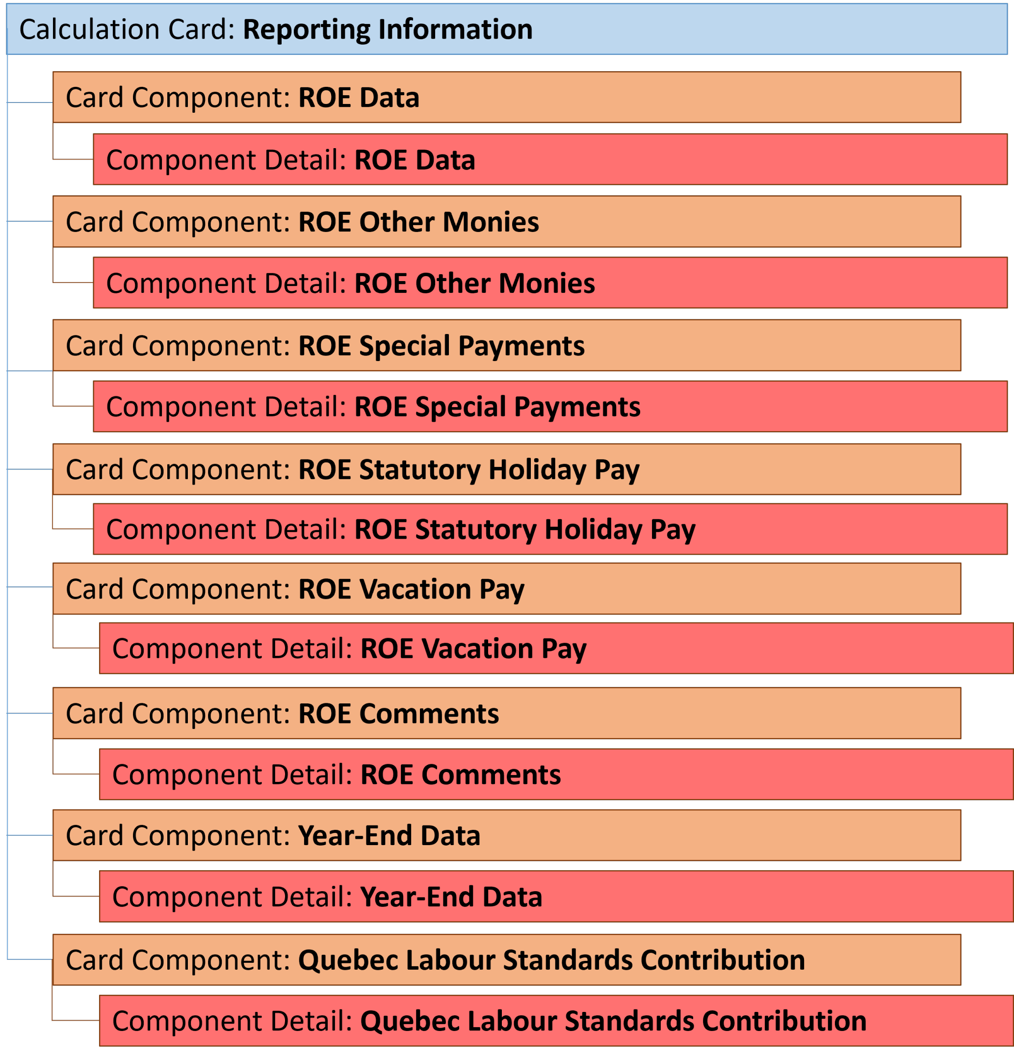

Reporting Information Card Component Record Hierarchy
To create a card component for the Reporting Information card component, you need to supply two record types: Card Component and Component Detail. The detail creates data within flexfield segments applicable to the component.
