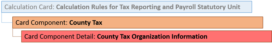

County Tax Card Component Hierarchy
The County Tax card component has this shape:
The County Tax card component uses the County Tax Organization Information flexfield context and data for this is loaded using the Component Detail record type.
