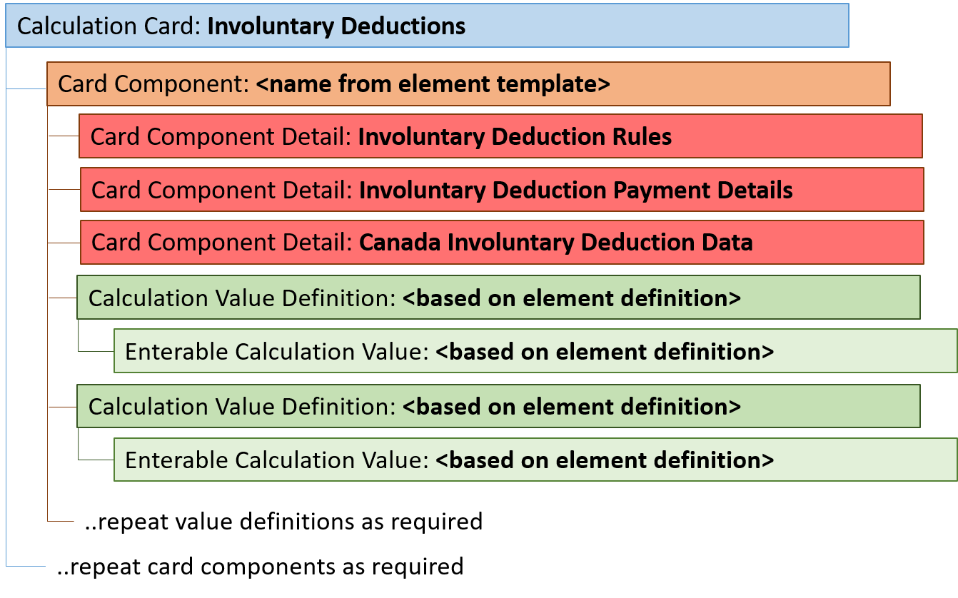

Involuntary Deduction Calculation Card Hierarchy
The hierarchy of Calculation Card components applicable to Involuntary Deductions is dependent upon the type of involuntary deduction being reported, but generally has this shape:
A separate card component is required for each involuntary deduction type. There is only one Involuntary Deduction card for an employee.
The card component name is defined by the element configuration, as are the value definitions, which are supplied using the Calculation Value Definition and Enterable Calculation Value record types.
There are three flexfield contexts available, of which the Canada Involuntary Deduction Data context is optional. Data for these is loaded using the Component Detail record type.
