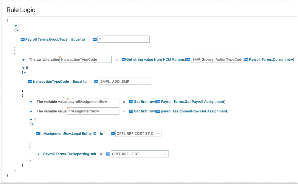

Autocomplete Rules for Tax Reference Unit
You can default the TRU from the HR assignment attributes, using the Payroll Terms business object. When you create rules:
                  Select Field Modification Rule Type in the Rule Type field.
                  Select Payroll Terms in the Business Object field.
                  Select Default Payroll Values Indicator in the Field field.
Autocomplete rules are supported in the following transactions:
               Hire an Employee
               Add contingent worker
               Add Non Worker
               Add Pending Worker
               Add Assignment
               Add Temp Assignment
               Create Work Relationship
               Add a Pending Worker
               Create and Edit Offer
               Local and Global Transfer

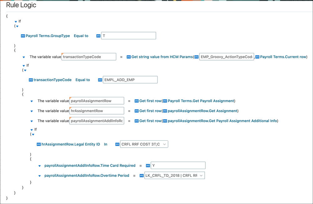

Here's some sample screenshots that illustrate the Autocomplete rule logic.  The value
            of the EMP_Groovy_ActionTypeCode HCM Params function must match the ActionTypeCode of
            the respective flow (such as New Hire, Local and Global Transfer, Add Assignment, and so
            on).
