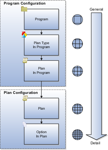

Setup effort and operating performance vary depending on where you define eligibility requirements within the benefits object hierarchy. This example illustrates best practices.
You can use the eligibility pages in the Setup and Maintenance and Plan Configuration work areas to define eligibility requirements at:
Three levels when configuring programs: program, plan type in program, and plan in program
Two levels when configuring plans: plan not in program and option in plan

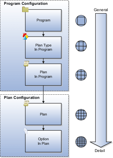

When evaluating eligibility requirements, detail-level requirements augment general-level requirements, rather than overriding them. Therefore, you associate successively restrictive requirements as you move down the hierarchy.

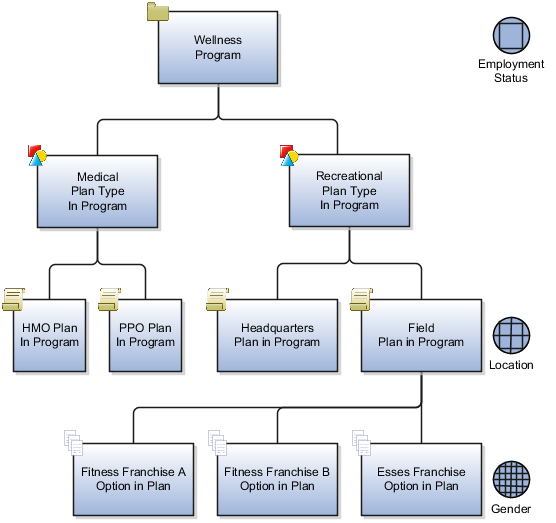

Your organization is creating a wellness program that's for current and retired employees only. The program hierarchy includes the following configuration:
Two plan types: medical and recreational.
Two plans within the recreational plan type:
A headquarters plan that provides access to an on campus recreation facility.
A field plan that includes options for three national franchises. One franchise restricts membership to the female workers.
