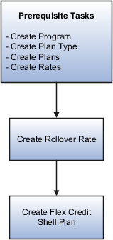

The following figure shows the tasks to complete in this example.
