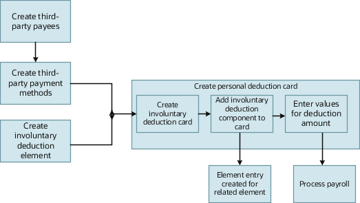

Before you Begin
Before you can add an involuntary deduction to a personal calculation card, you must first:
Create an organization payment method that's unique for the involuntary deductions. Associate this payment method to the payroll.
Create a third party (organization or person) to receive the payment and associate the organization payment method.
Create an involuntary deduction element and the element eligibility.
You can create multiple elements for the same involuntary deduction type if processing information or other details vary. For example, each jurisdiction you deal with may have different processing rules for court orders.
How to Create an Involuntary Deduction Calculation Card
Here are the steps for creating an Involuntary Deduction calculation card:

How to Add the Calculation Component to the Calculation Card
Add multiple calculation components for the same or different involuntary deduction types. For example, you could add two child support components and one garnishment component to the same calculation card.
