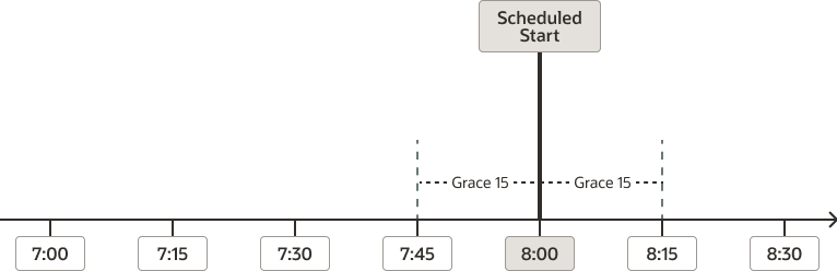

Grace Period
A grace period is the number of minutes that individuals can deviate from their published scheduled start and stop times without getting attendance violations. This deviation applies both before and after the scheduled time. For example, when a shift with a 15-minute grace period starts at 8:00, the valid start period is 7:45 to 8:15.
Timeline starting at 7:00 and continuing beyond 8:30 marked at 15 minute intervals. It shows the 15 minute grace periods from 7:45 to 8:00 and 8:00 to 8:15.

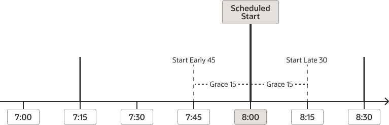

Start and End Early and Late Periods
Early and late periods are ranges of time in minutes, before and after scheduled start and end times. These periods help time device rules evaluate time device and web clock events using identified shift start or stop times. For example, a scheduled shift starts at 8:00. It has a 15-minute grace period, a 45-minute start early period, and a 30-minute start late period.
  • The 45-minute start early period includes the 15-minute grace period. So, the start early period is 7:15 to 8:00.
  • The 30-minute start late period includes the 15-minute grace period. So, the start late period is 8:00 to 8:30.
Timeline starting at 7:00 and continuing beyond 8:30 marked at 15 minute intervals. It shows the 15 minute grace periods from 7:45 to 8:00 and 8:00 to 8:15 and the example start early and late.
