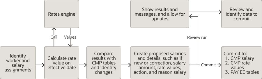

When you submit the Run Rates-based Salary Process process, you specify whether to create salaries or correct salary records, by recalculating rate values. You use population filters to identify the workers and salary assignments the process should check. Use the run type to specify whether to commit the new or corrected salaries to the CMP salary, CMP rate values, and PAY EE tables. Or you can specify to wait for review.
When it runs, the process calculates what the rate values will be on the effective date and compares the results with CMP table values to identify salary changes. It creates salary proposals and details. For example, the process identifies whether the proposal is for a new salary or a correction and includes the salary amount, rate values, action, and reason. If you specified to wait for review, you review the Run Rates-based Process results using the Review Proposed Salary Changes and Rate Values task.

Here's a flow diagram of Run Rates-based Process.
