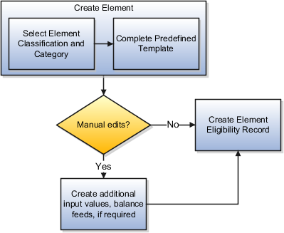

Manage Elements
When you create an element, your selection of the element classification and category determines the questions on a predefined template. Submitting the template generates an element, which you can edit, as required.
You must create at least one element eligibility record for all predefined and newly created elements.
This figure shows the tasks involved.
