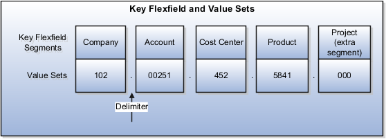

Structure of the Cost Allocation Key Flexfield
Decide what structure to use for the cost allocation key flexfield and use the Cost Allocation Key Flexfield to set it up.
The structure of the flexfield defines the segments such as their order and the value sets used to validate the data entered in the segments. Configure each segment of the cost account. For example:
Segment 1 = Company
Segment 2 = Cost Center
Segment 3 = Account Number
Segment 4 = Project Code
For example, the salary cost account number is 01.200.60001.987654 for a company with the following cost allocation key flexfield setup:
Company = 01
Cost Center = 200
Account Number = 60001
Project Code =987654
