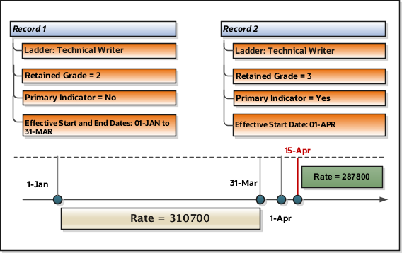

Results
On 15-April, the compensation user updates the employee's salary rate from the retained grade rate to the grade rate. As shown in the table and illustration, the application returns these rate values.
                         Period  |
                         Rate  |
                         1-Jan to 31-Mar  |
                         310700  |
                         15-April 2020  |
                         287800  |
As shown in the illustration, depending upon the effective start and end dates, the application returns the corresponding rate value.
