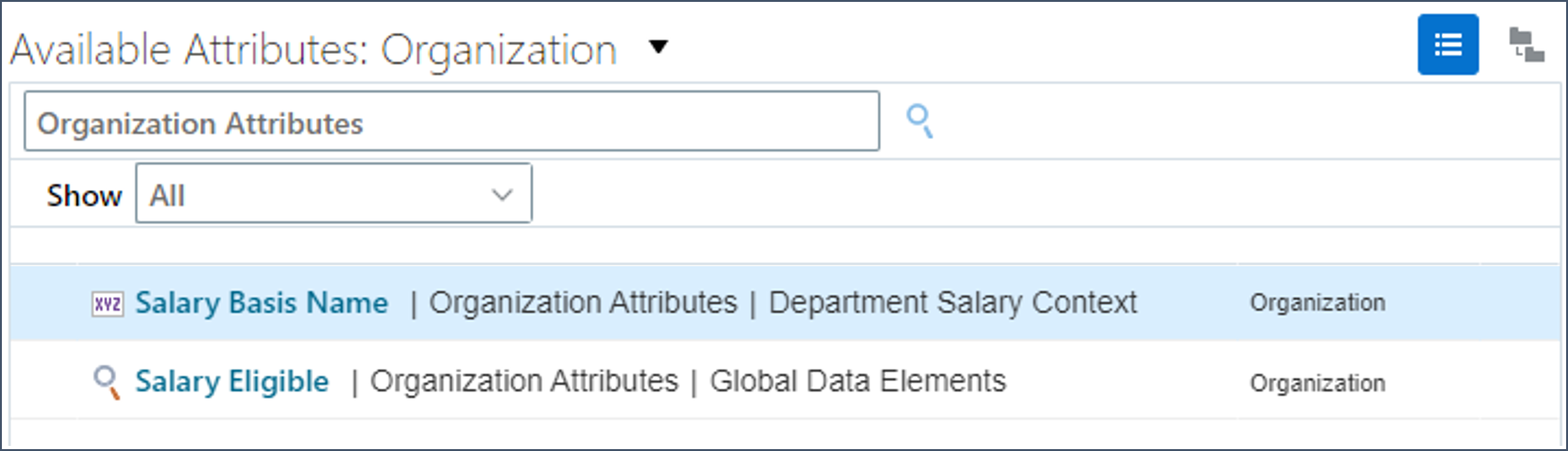

Add Descriptive Flexfield Segments
DFF segments are defined on the same record as the base attributes so you can't have multiple DFF contexts for the same spreadsheet row. You're therefore restricted to including segments from one flexfield context in addition to segments from the Global Data Elements context.
- Display the Available Attributes for the Organization component.
- Select attributes from the DFF context you want to use and add them to the template, along with any Global Data Elements context attributes you need.
- Edit the Context Value to define a constant default value of the flexfield context code for the descriptive flexfield segments added. This attribute can be hidden.

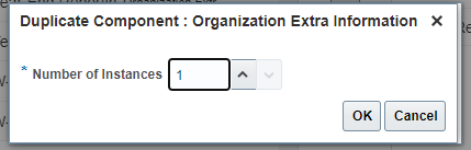

- Click on any of the Organization Extra Information attributes in the Selected Attributes panel and click Duplicate.
- Specify 1 when prompted for the number of instances to create.
- Click OK. This creates a copy of every attribute you selected for the Organization Extra Information component.
- Edit attribute Reporting Name | 1 to hide it.

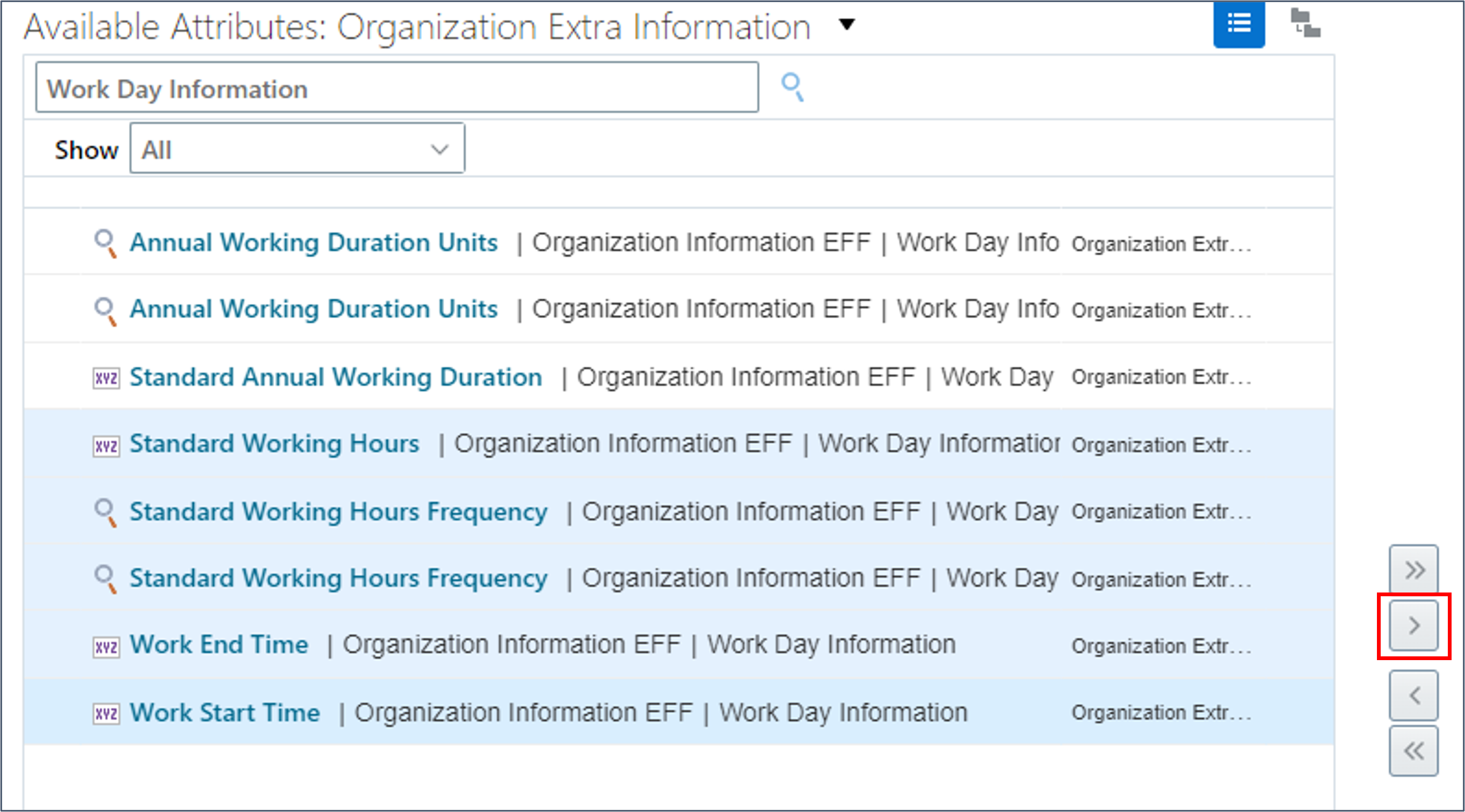

Adding Segments for Another Context
- Search for available attributes in the Work Day Information context.
- Add these attributes from the Work Day Information context to your template:
- Standard Working Hours
- Standard Working Hours Frequency
- Work Start Time
- Work End Time
