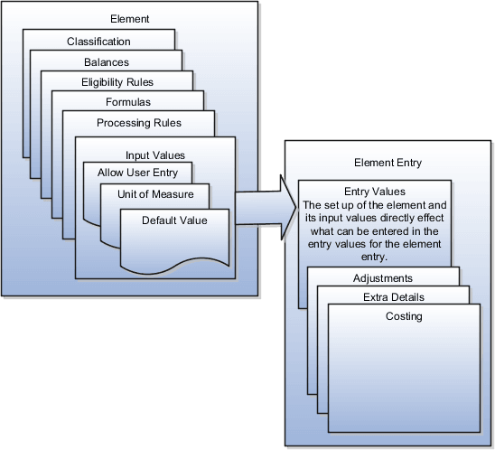

How Element Setup Affects Entries and Their Values
An element's input values define the entry values available on each entry of this element.
For each input value that's marked for display, an associated element entry value is available on the Element Entries page.
Some entry values provide inputs to element calculations, such as hours worked.
Others results from payroll calculations. For example, elements processed earlier in the payroll run.
