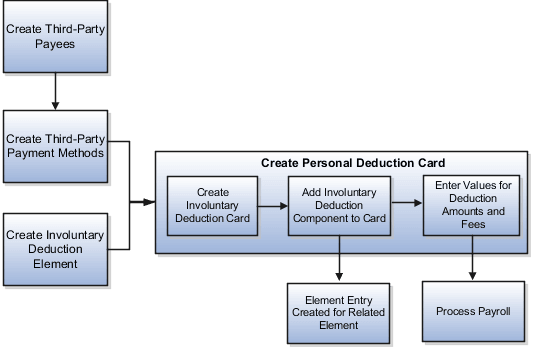

This figure shows the steps involved in creating an involuntary deduction and adding it to a personal calculation card:

Before you can add an involuntary deduction to a personal calculation card, you must first:
Create an organization payment method that's unique for the involuntary deductions and has a payment type of cheque. Associate this payment method to the payroll.
Create a third party (organization or person) to receive the payment and associate the organization payment method.
Create an involuntary deduction element and the element eligibility.

How to Create an Involuntary Deduction Calculation Card
Here are the steps for creating an Involuntary Deduction calculation card::
In the Payroll area under My Client Groups, search and select the Calculation Cards task.
Search for and select the payroll relationship.
If the person doesn't already have an involuntary deduction calculation card, click Create.
Enter a start date for the card and select the involuntary deduction card type.
Click Continue.
