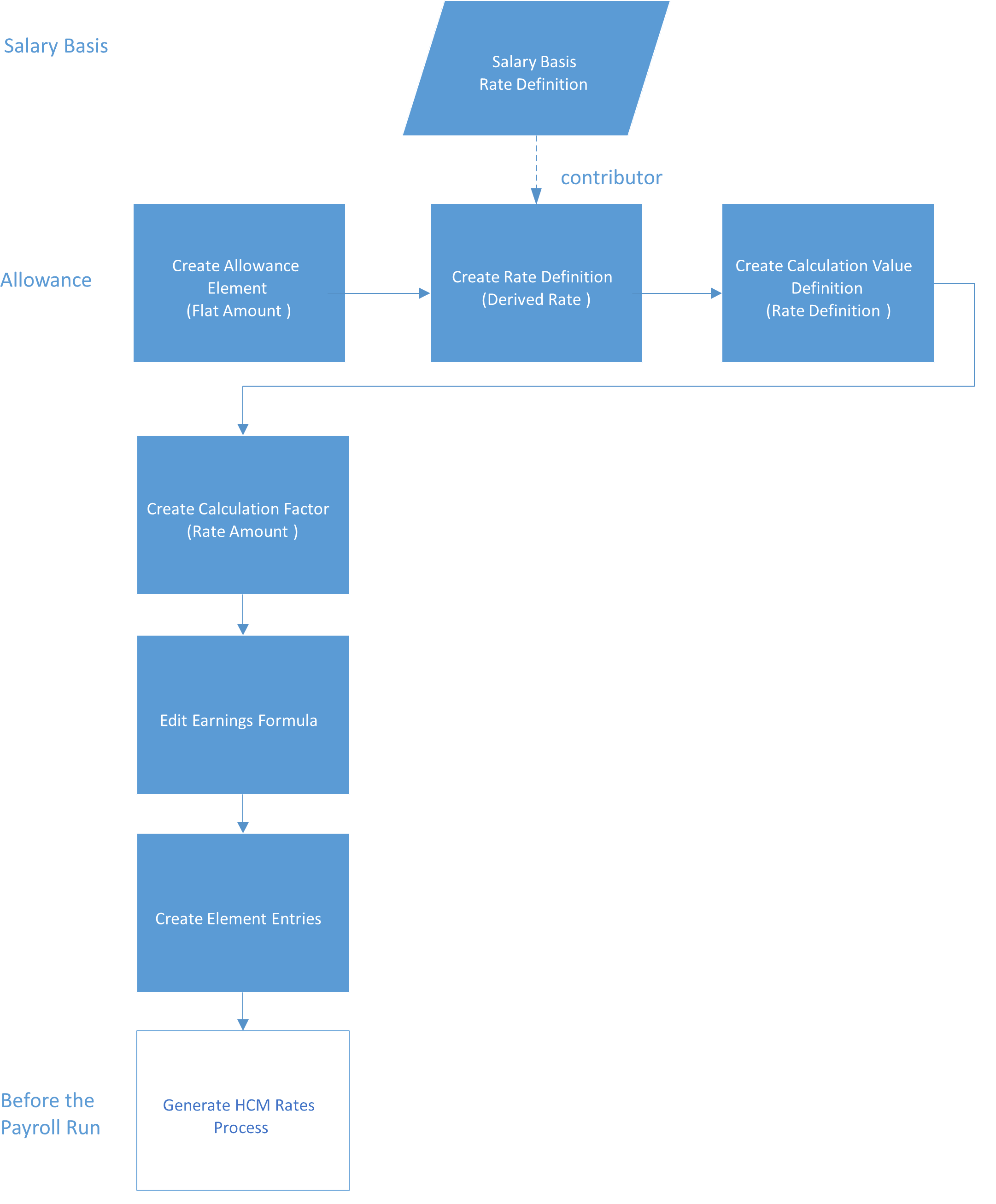

Overview of Single-Rate Allowances
Follow the steps described here to create an allowance that is payable to eligible employees in the organization at the same rate.
This is applicable where there is no variation in rate at employee level, but the rate is
based on the employee’s salary.
The following table summarizes the tasks and setup decisions.
| TASK | ATTRIBUTE | VALUE |
| Create Allowance Element | Calculation rule | Flat amount |
| N/A | Periodicity | Annual |
| Create Rate Definition – Salary Basis | Category | Element |
| N/A | Storage Type | Amount |
| N/A | Element Name | User-defined salary basis element |
| Create Rate Definition – Derived Rate | Category | Derived Rate |
| N/A | Factor Rule | Value |
| N/A | Contributor Type | Rate Definition |
| N/A | Contributor Name | User-defined salary basis rate definition |
| Create Calculation Value Definition | Calculation Type | Rate Definition |
| N/A | Calculation Values - Rate Definition | User-defined rate definition created for derived rate |
| Create Calculation Factor for Allowance Element | Calculation Step | Rate Amount |
| N/A | Calculation Value Definition | User-defined calculation rate definition |
| Edit Earnings Formula | Formula Name | User-defined flat amount allowance element |
| Create Element Entries | N/A | N/A |
| Run Generate HCM Rates Process | Process Mode | Full |
