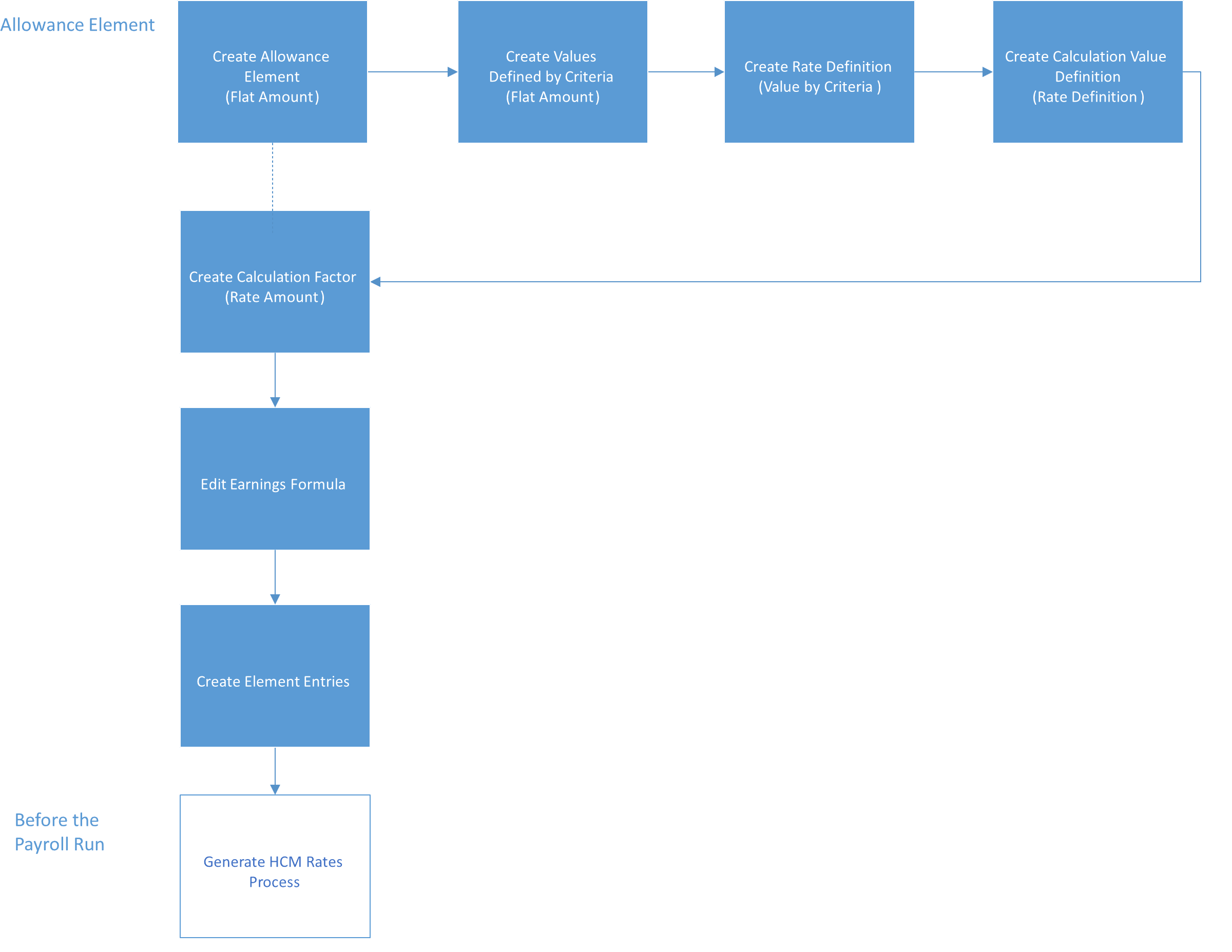

Overview of Value by Criteria Allowance Setup
Follow the suggested steps described in this section to set up an allowance that is paid at differing rates according to the criteria your organization uses.
See Values Defined by Criteria in Implementing Global Human Resources for more information.
It is a prerequisite that you complete the steps in the Common Setup section of this document.Value by Criteria Allowance Setup
The following table summarizes the tasks and setup decisions.
Value by Criteria Allowances Setup Summary
TASK ATTRIBUTE VALUE
Create Allowance Element Calculation rule Flat amount
N/A Periodicity Annual
Manage Descriptive Flexfields N/A Optional task - if additional information required to record criteria
Create Values Defined by Criteria N/A N/A
Create Rate Definition Category Value by Criteria
Create Calculation Value Definition
Calculation Values - Rate
Definition
User-defined rate definition created previously.
Create Calculation Factor for Allowance Element Calculation Step Rate Amount
Calculation Value Definition User-defined calculation
Edit Earnings Formula Formula Name User-defined flat amount allowance element
Create Element Entries N/A N/A
Run Generate HCM Rates Process Process Mode Full

Create Allowance Element;
Create a new flat amount earnings element for your allowance:
  1. Using the Elements task, click Create to create a new Regular Earnings element (standard category).
  2. Select Flat Amount as calculation rule and Annually as the periodicity.
  3. In the Special Rules section, select the user-defined allowance proration event group and the default Entry Changes for Retro event group.
  4. Review the element details and enter further information in the UK Element Information region, including the element type (allowance). This ensures the allowance is included in the Allowance Code and Allowance History files. (If there is no Allowance element type, the allowance is not identified as liable for MyCSP reporting.):
Create the criteria and values that your allowance will use:
  1. Using the Values Defined by Criteria task, click Create to create a new value by criteria definition.
  2. Create the criteria and calculation value definitions for each set of criteria:
Create Rate Definition – Value by Criteria
Create a new rate definition to associate with the values by criteria definition:
  1. Using the Rate Definition task, click Create to create a new rate definition. The category must be Value by Criteria.
  2. Select the Value by Criteria Name created previously. The Calculate Live Rates field must be unselected and Reporting Required selected. Then submit the rate definition.
Create a new calculation value definition to associate with the value by criteria definition:
  1. Using the Calculation Values Definition task, click Create to create a new calculation value definition.
  2. Enter the details as shown:
    FIELD VALUE
    Name User-defined value by criteria definition created previously.
    Calculation Type Rate Definition
  3. Select Date Earned in the Retrieval Date field.
  4. Create a range of values in the From Value and To Value columns and link the calculation value definition to the Derived Rate definition created previously.
Create a calculation factor for the flat amount allowance element and link it to the calculation value definition created previously:
  1. Using the Elements task, search for the flat amount allowance element.
  2. Select Calculation Factors and click Create to create a new calculation factor.
  3. Enter the details as shown:
    FIELD VALUE
    Calculation Value Definition User-defined value definition created previously.
Once the above setup steps are completed, you can create element entries for employees who are in receipt of this type of allowance:
  1. Using the Element Entries task, select the flat amount allowance element.
  2. The pay value for the flat amount allowance element is recorded on the rate definition and not the element entry, therefore the Amount field is blank on the element entry.
Next, run the Generate HCM Rates Process prior to running your payroll.
