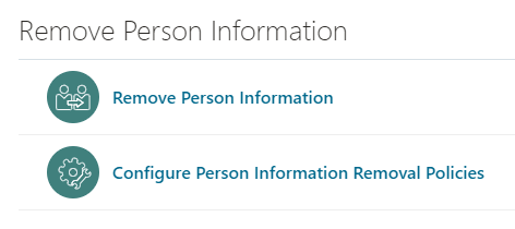

To remove a person information, you need to have access to the following pages:
Configure Person Information Removal Policies: Configure the business objects and its components that you want to remove and mask mandatory attributes. To access this page, you must have the Configure Person Information Removal Policies privilege
HRC_CONFIGURE_PERSON_INFO_REMOVAL_POLICIES_PRIV. -
Remove Person Information: You can remove person information for specified people from this page. When you submit the person information removal process, the data is removed as per the configuration defined in the associated person information removal policy.

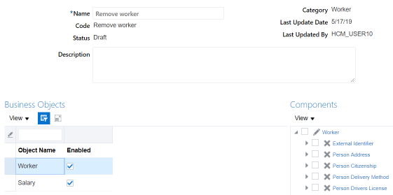

To create templates and configure removal policies:
Click Create to open the Create Template window. Required fields are:
NAME: The name of the template.
CODE: The template code, defaults to the name of the template.
CATEGORY: The Business Object the template is created for: the options are Worker or Candidate.
DESCRIPTION (optional): The user can also enter a description.
Select one or more Business Objects.
Under the Business Objects section, search for a specific business object and select objects to process. The Components section, select the child objects under the selected business object.
Note:- When you select a component with associated dependent objects, you're recommended to select the dependent objects to avoid orphan data.

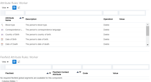

Use the Rules tab to configure policies. Most objects are configured for deletion, so no specific rules are needed for those objects. You can configure rules for objects if they contain attributes that can only be obfuscated and cannot be deleted. If you specify a generic value to include in a field, you can use any value except null. For example, the Person Last Name can't be deleted, so it needs to be replaced by a static value. ZZZZZ is the default. The Person Last Name will be replaced by this static value appended by an internal identifier, to maintain the uniqueness of this attribute and thus the data integrity. Notice the Search boxes for Attribute Names and Description.
You can remove flexfields that are registered in HCM Data Loader registered like any business object. Upon deletion, only required global segments of flexfield attributes remain and the rest is removed automatically.

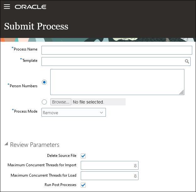

To start the Remove Person Information process, perform these steps:
Click Submit Process
Enter a process name and select a template from the searchable list.
Enter the Person Numbers, separated by commas, which are to be deleted or obfuscated.
Note:You can also upload a file containing a list of Person Numbers separated by commas.
Select a Process Mode: Report or Remove.
Note:The Remove mode is an ESS process that extracts key information for the records to be deleted or masked and generates an HCM Data Loader business object .dat file for each business object in the selected policy. The generated .dat files are zipped together and uploaded with HCM Data Loader. The Report mode only produces the .dat file that is zipped and can be downloaded locally for review. HCM Data Loader does not process the .dat file and no information is deleted or obfuscated when run in Report mode.
- In the Remove mode, you can set the following
additional runtime parameters to override the default HCM Data Loader values in
the Review Parameters section:
- Delete Source File: Deletes the data set file from UCM.
- Maximum Concurrent Threads for Import: Maximum number of concurrent threads to assign to the import process. The default is defined by the Maximum Concurrent Threads for Import parameter in the Configure HCM Data Loader task.
- Maximum Concurrent Threads for Load: Maximum number of concurrent threads to assign to the load process. The default is defined by the Maximum Concurrent Threads for Load parameter in the Configure HCM Data Loader task.
- Run Post Processes: Submits the business object post processes and the Oracle Search Bulk Ingestion process.
- In the Report mode, you can only set the Run Post Processes review parameter.
Note: If you deselect the Run Post Processes parameter while clicking Submit, then a warning message displayed to indicate that post processes, including Oracle Search Bulk Ingestion, will not be executed for this Data Disposal process. - In the Remove mode, you can set the following
