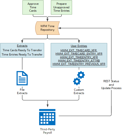

For example, you want to transfer approved time data or unapproved but appropriately prepared time entries to a third-party payroll application. Here's what you can do:
- Extract the appropriate data for payroll processing using either the Time Cards Ready To Transfer Extracts or Time Entries Ready To Transfer Extracts extract. Or you can create your own extracts with the delivered HWM_EXT user entities and database items. Either way, use the task and the HR Archive extract type.
- Load the extracted data in your third-party payroll app.
- For each transferred time entry, send the updated status to Time and Labor from the external payroll app using the statusChangeRequests REST service.
- Update the statuses in the time repository by running the Update Extracted Time Cards from Ready to Transfer to Transferred process.
