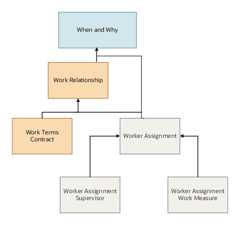

Navigation From and To Worker Assignment
The Worker Assignment object is a part of Employment and closely linked to the When and Why object.
In addition to directly using this object for defaulting and validating, you can also use it as a criteria to achieve other defaulting and validating in objects that are called in subsequent regions involving the Employment Details region.
