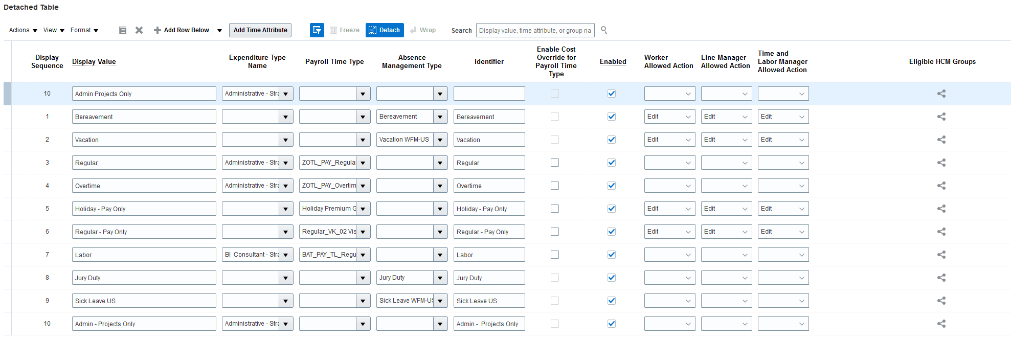

Add and configure each field value in the attribute definition table.
