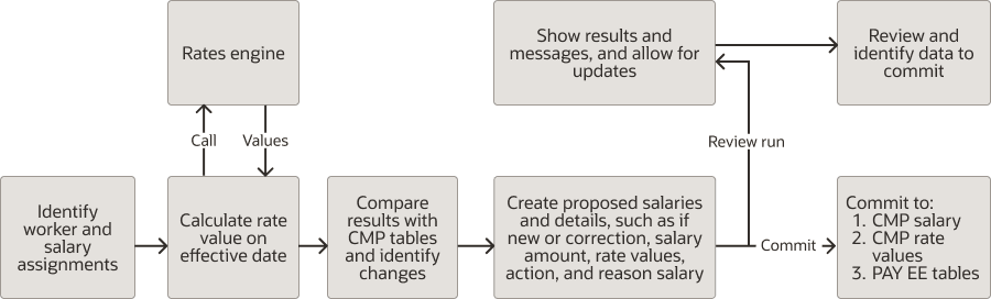

Here's a flow diagram of Run Rates-based Process.
Process flow for Run Rates-based Process.
