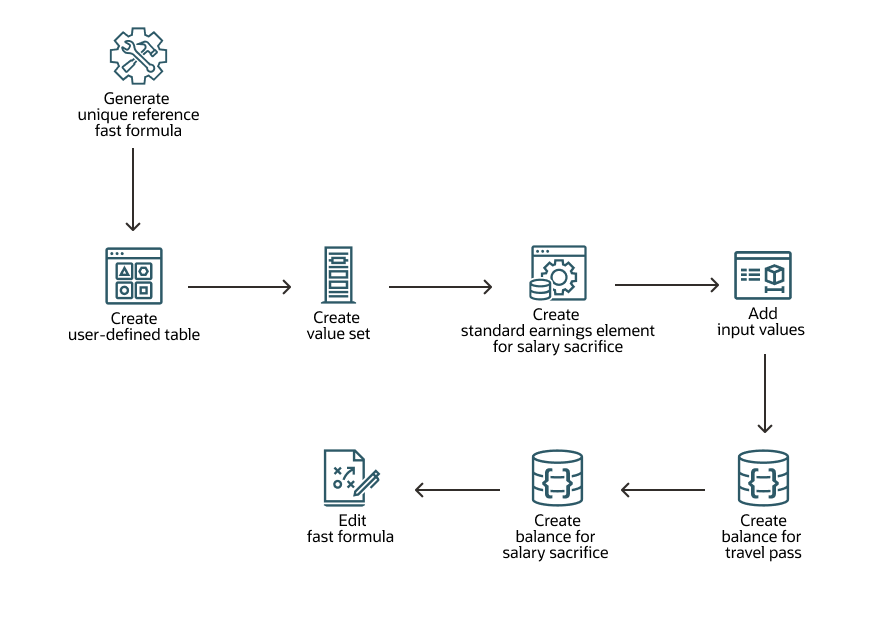

Set up salary sacrifice for Ireland
Using this sample configuration, you can set up salary sacrifice for earnings such as Travel Pass and Cycle to Work.
  • Set up fast formulas to generate unique reference.
  • Create user-defined table and value set.
  • Create the required salary sacrifice element using the earnings element template.
  • Ensure that it contains an input value of Amount (or similar) and Unique Reference.
  • The priority of the salary sacrifice earnings element should be such that it runs after all other earnings elements.
  • Even though the element is an earnings element, it’s behavior is like a Loan element. You need to track the opening balance, partial recoveries (in case of insufficient earnings), recovery total earnings from a termination period and STOP rule when the total amount is paid off.
  • Use the sample changes recommended to the template generated fast formulas while creating the element.
