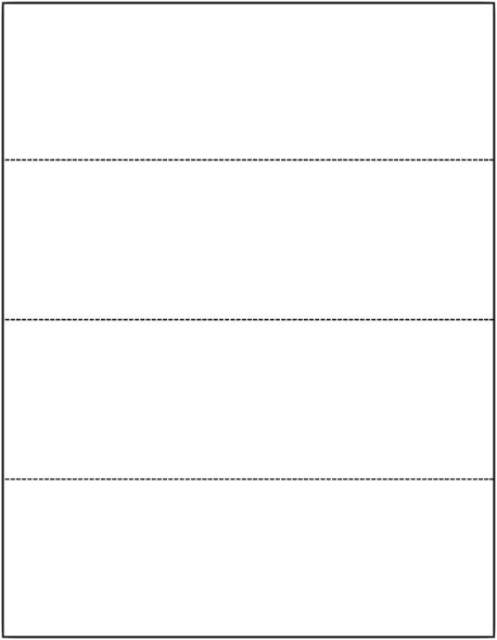

Print File
A single master PDF file that contains all year-end forms marked for print delivery. This file is sorted by:
  1. PSU
  2. TRU
This file is formatted to print on 4up perforated paper, with four W-2s or W-2GU per page. W-2PR uses a single form per page. Depending on how you set Print Instructions, it might include the standard employee instructions on a separate page.
This flow excludes any employees with exceptions, such as negative balances or 0 gross wages. Use the W-2 Register report to identify these employees.
For terminated employees, this flow overrides the print preference value and enforces print delivery.
Form W-2 and W-2GU 4up format:
This image displays the format of Form W-2 and W-2GU 4up paper stock.
