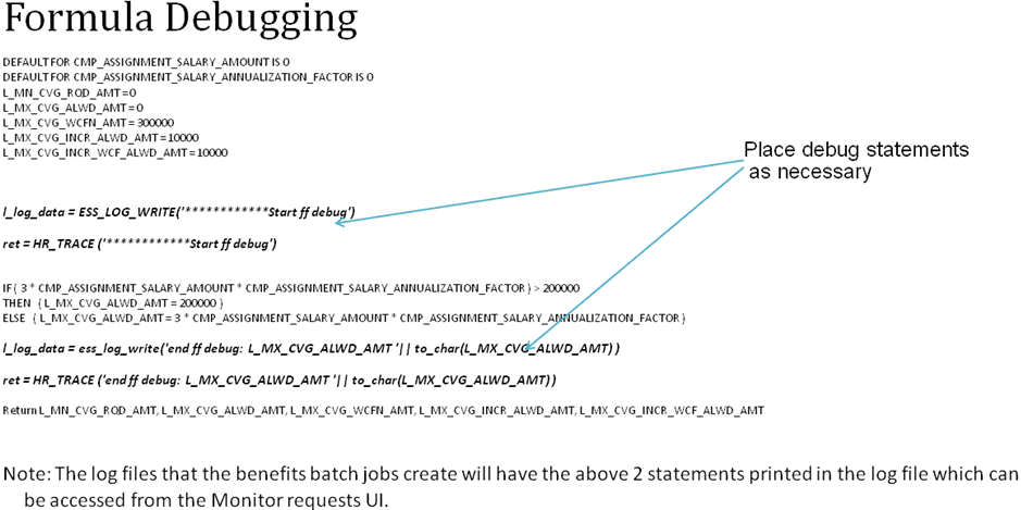

Formula Debugging and Troubleshooting
You need to place the following debug statements as necessary:
l_log_data = ESS_LOG_WRITE('*************Start ff debug - messages appear in
the batch process log files')
ret = HR_TRACE('*************Start ff debug - messages appear in the PLSQL
trace file')
l_log_data = ess_log_write('end ff debug: L_MX_CVG_ALWD_AMT'||to_char(L_MAX_CVG_ALWD_AMT))
ret = HR_TRACE('end ff debug: L_MX_CVG_ALWD_AMT'||to_char(L_MX_CVG_ALWD_AMT))
