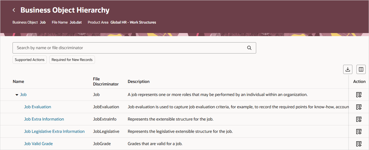

  10. Click on the Job Business Object name to navigate to the Business Object Hierarchy page.
  11. You'll see the business object hierarchy, click the object in the hierarchy that you want to find the flexfield attribute information for.
  12. Business object hierarchy

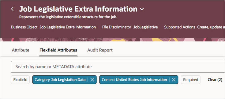

  13. Click on the Flexfield Attributes tab.
  14. Filter the list of attributes using the search filters. Most objects have only one Flexfield. For extensible flexfields, the Category filter is also available.
    Specify the filters
  15. The Name is displayed in your session language and will be the same as the prompt in the application for the flexfield segment. The METADATA Attribute shows the string you need to include in your METADTATA line of your file when supplying a value to the flexfield segment:
