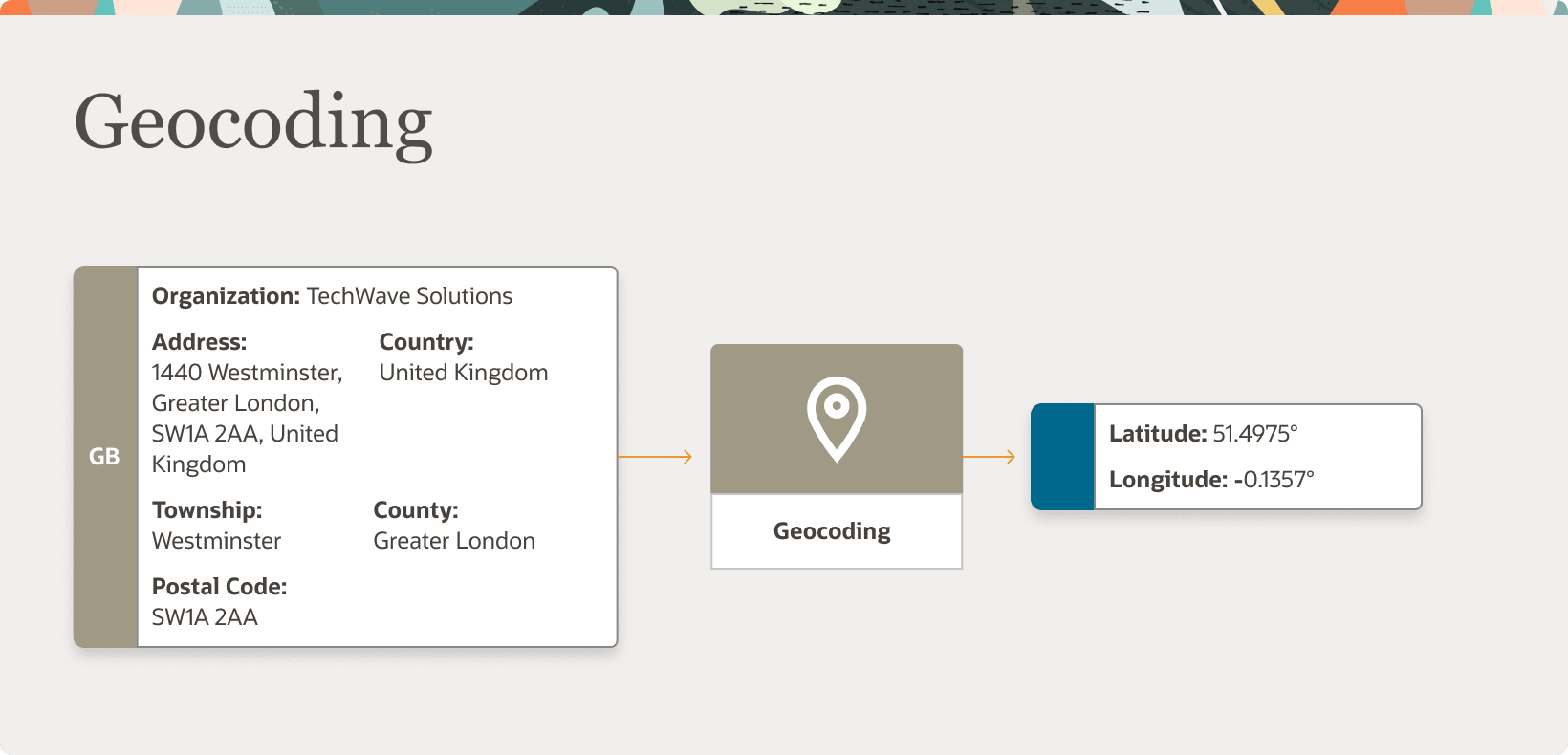

This image depicts the geocoding of a fictional organization named TechWave Solutions and finding its latitude and longitude.
