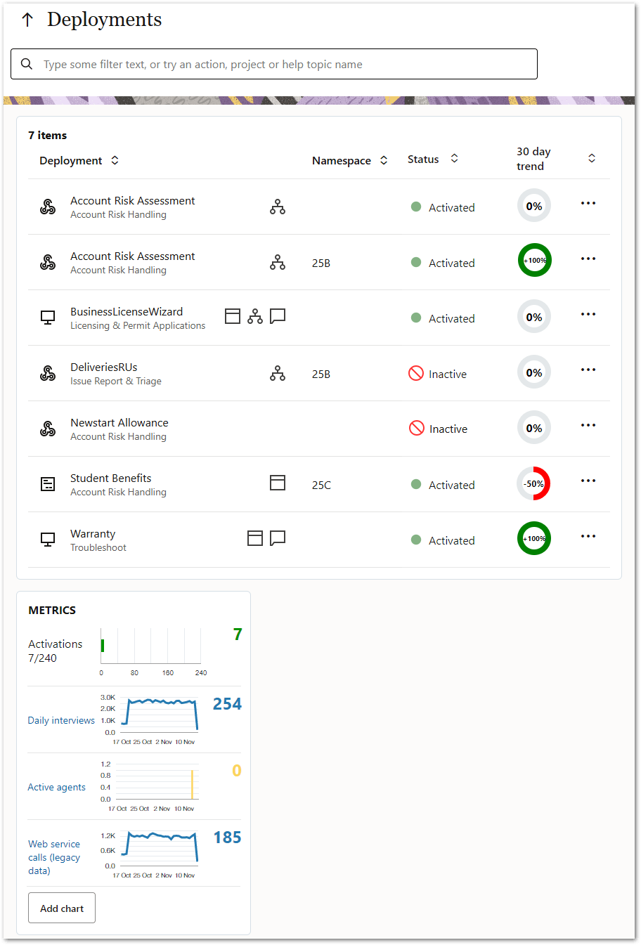

The Deployments page in Intelligent Advisor Hub is where all the projects that have been deployed are displayed. This includes both Policy Modeling projects deployed from within Policy Modeling and decision service and flow projects deployed from the Projects page in the Hub.
Image of the Intelligent Advisor Hub Deployments page listing multiple deployments

On the Deployments page you can:
  • Use the up arrow to navigate back to the dashboard page
  • Use the search field to filter the list of deployments by name, workspace or namespace
  • View all deployed projects. For each deployment, the following information is displayed:
    • deployment type:
      • Policy Modeling project deployments are shown with a Policy Modeling project icon on Deployments page in Intelligent Advisor Hub icon
      • decision service project deployments are shown with a Decision service project icon on Deployments page in Intelligent Advisor Hub icon
      • flow project deployments are shown with one of the following icons: The icon for a dialog-type flow project in Intelligent Advisor Hub dialog, The icon for a chat-type flow project in Intelligent Advisor Hubchat, The icon for a workflow-type flow project in Intelligent Advisor Hub workflow, The icon for a task-type flow project in Intelligent Advisor Hub task, The icon for a request-type flow project in Intelligent Advisor Hub request, The icon for a flow-type flow project in Intelligent Advisor Hub flow. This icon is configured in the flow scheme settings.
    • name
    • workspace
    • channels that the deployment has been activated on:
      • interviews are shown with a An image of the Interview icon on the Deployments page of Intelligent Advisor Hub icon
      • web service endpoints are shown with a An image of the Endpoints icon on the Deployments tab of Intelligent Advisor Hub icon
      • chat services are shown with a Image of the Chat service icon on Deployments tab in Intelligent Advisor Hub icon
      • active debug logging is shown with a Image of the debug logging icon on Deployments tab in Intelligent Advisor Hub icon
    • namespace (if the project is in a namespace)
    • status (Activated, Activated in compatibility mode or Inactive). Currently activated deployments are shown with a The icon used in Intelligent Advisor Hub to indicate an active deployment icon. Non-activated deployments are shown with a The icon used in Intelligent Advisor Hub to indicate an inactive deployment icon. Deployments with a warning are shown by a yellow warning icon. This could indicate that the deployment has been activated in compatibility mode and/or that the deployment has recently used APIs that are scheduled for removal.
    • 30 day trend indicators
  • Sort the data by clicking on the up/down arrows in any of the column headings
  • See charts showing site statistics
  • Click on a deployment name to view and edit the details for that deployment. For more information, see View or change deployed projects in Intelligent Advisor Hub.
  • Click the interview icon to launch the interview for the deployment. For more information, see Test an Activated Interview.
  • Click the web service icon to show the endpoints for the web services for that deployment. For more information, see Run a Web Service (for Policy Modeling project deployments) or Run a Project as a Decision Service (for decision service project deployments).
  • (Managers only) Click on the menu for a deployment to delete the deployment.
  • Click on a chart to open the Site Statistics view for that metric. For more information, see View Site-Wide Deployment Statistics.
  • Click Add chart to create a new deployment statistics chart that will be displayed on the Deployments page. For more information, see Add a Deployment Statistics Chart.
  • Hover over any errors to see what the problem is
