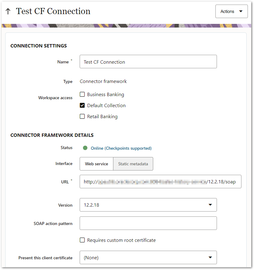

    This will display the details page for the connection.
    An online connector framework connection in Intelligent Advisor Hub
    For more information on these connection settings, see Connect to a Specific External Application. Note that for online connections, the Status will also indicate whether checkpoints are supported.
