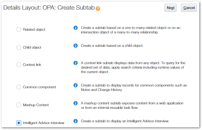

To add an Intelligent Advisor interview as a subtab, you can use the Intelligent Advisor interview subtab type in Application Composer.
The Create Subtab page in Oracle Fusion showing the Intelligent Advisor interview option selected
(If the Intelligent Advisor interview option is not present, try deleting and recreating the connection to the Oracle Fusion site. This should reset the OPA_HUB_URL topology manager entry and make the Intelligent Advisor interview option reappear.)

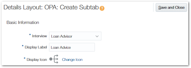

This control gets the list of available interviews on the connected Intelligent Advisor Hub for you to select from. The subtab name and icon can also be configured.
The Create Subtab Basic Information page in Oracle Fusion showing the configuration of the Intelligent Advisor interview
For the detailed steps required for this implementation, see Intelligent Advisor Interview Subtabs. Note that using this control does not support checkpoints. A checkpoint-enabled interview requires a different implementation using mashup content (see below) and groovy script.
