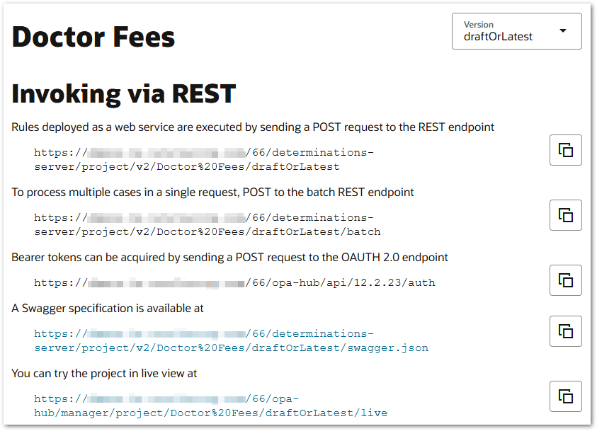

The specific URLs for your decision service project are available from the run project web page. You can access this page by selecting View REST Details in the Actions menu of a decision service project.
On this page you can use the copy buttons to copy the provided endpoints. You can also change the project version that is displayed using the Version drop-down.
The run project web page for a decision service project showing the URLs to invoke the project via REST

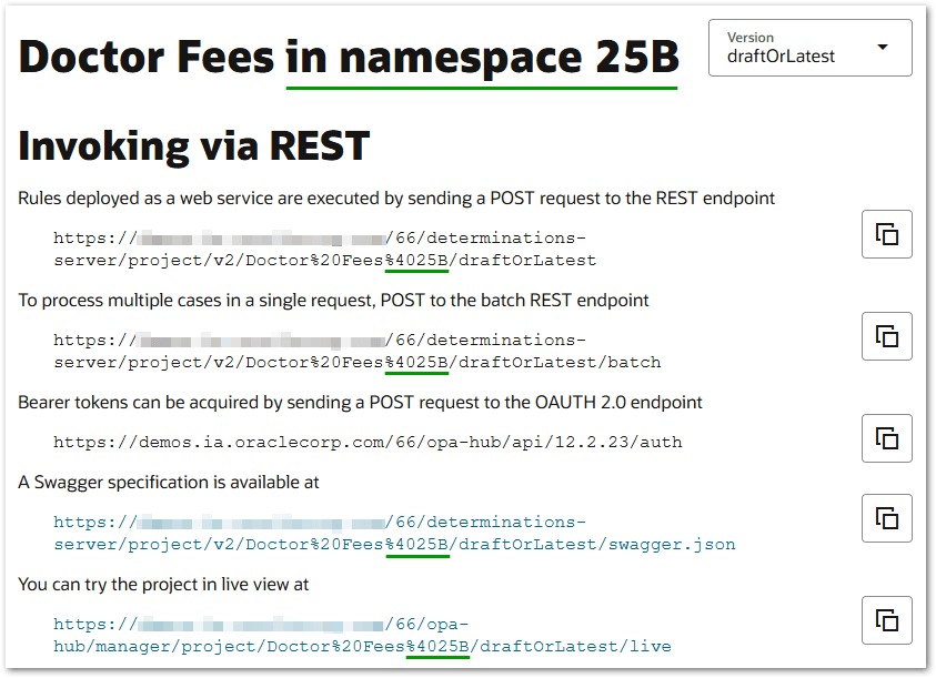

Note that if the project is in a namespace, this will be shown at the top of the page and reflected in the project name in the URLs (in URL-encoded format).
The run project web page for a decision service project in a namespace showing the URLs to invoke the project via REST
