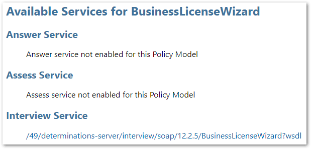

    A list of all available web services for that policy model will be displayed in a new browser window.
    The available web services shown in a new browser window.
  4. Click the link for the web service that you want to check. The WSDL for that web service end point is displayed. To understand what is displayed in the WSDL, see the SOAP Services Reference for the service and version you have selected.
