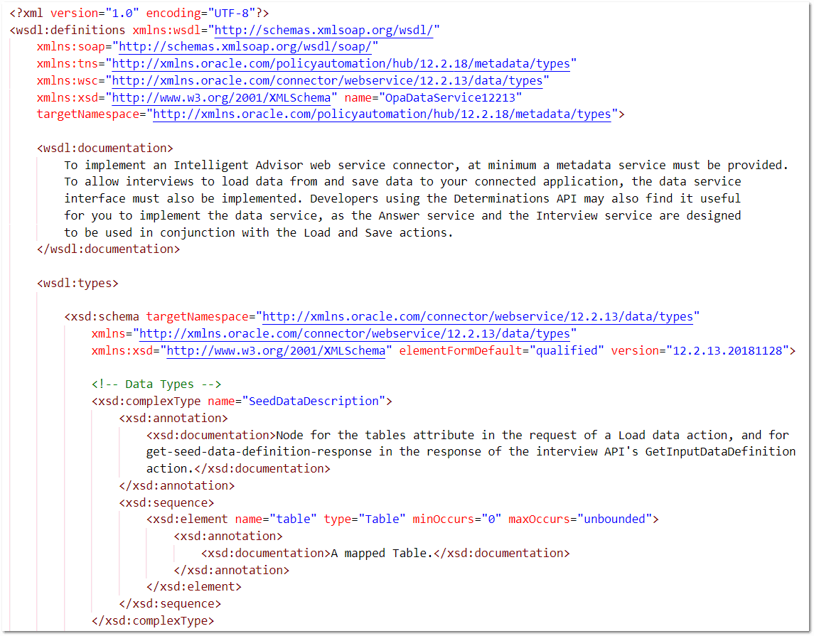

Download the Current Version of the Web Service Connector WSDL
The current version of the web service connector WSDL can be downloaded from Intelligent Advisor Hub by the Connections administrator. To do this:
  1. In Intelligent Advisor Hub, navigate to the Connections Page.
  2. Click the connector framework web service connection name.
    Tip: If you don't have a connector framework web service connection, create a 'dummy' connection purely for the purposes of downloading the WSDL. For more information, see Connect to a Specific External Application.
  3. On the connection details page, in the Actions menu, select Download web service WSDL. The current version of the WSDL will be downloaded.
    Image of the Web Service WSDL download (part only) available from the Connections tab on Intelligent Advisor Hub
